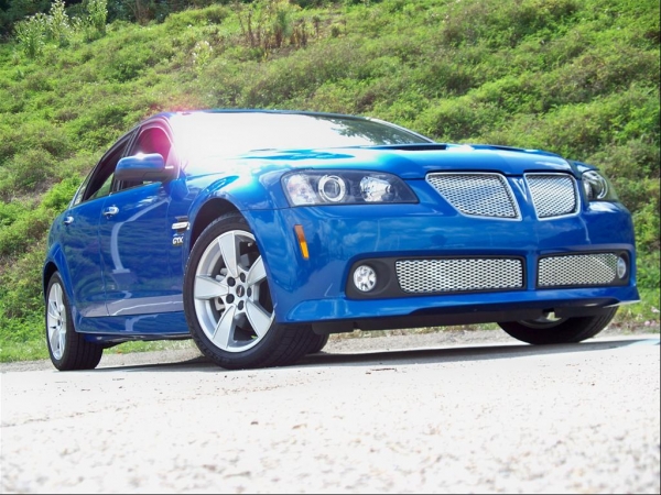

Yeah I know I can X the G8 wheel off my list. You are correct about no cruise on the wheel. I own a G8. The Cruise is on the stalk. Love my G8.
