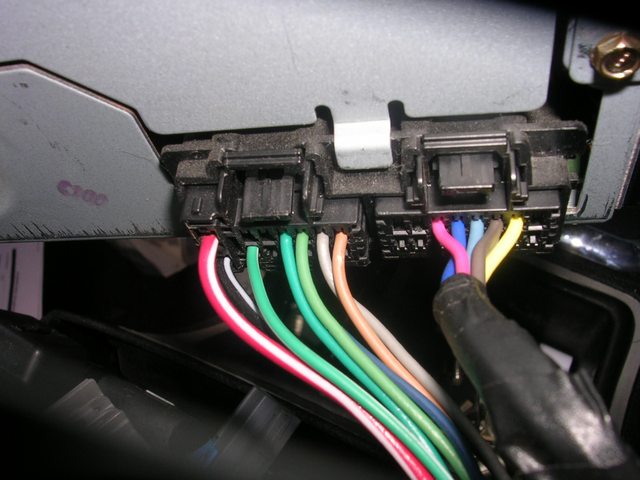

Cruise control went out again.
Seems to go out whenever I mess with the head unit.
Last time it stopped working was due to the scosche factory harness converter thing.
took it out, then cruise worked.
this time I have cut some wired from stock head unit harnesses, but for some reason, it worked like this. I actually hooked up MORE wires from harness to car wiring and now it doesn't work.
Does anyone know the wires on the head unit that would affect the cruise control?
It's literally the only thing I messed with.
Here are the colors for the wiring for my radio
