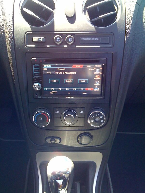

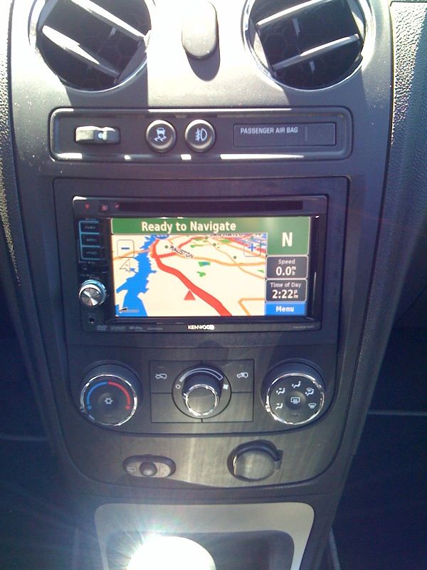

The Pioneer looks nice almost went with it. But I've had Kenwood in almost all my cars so went with the DNX5120. Got the Sirius and Bluetooth hooked up. But still have to add the steering wheels controls, iPod adapter, Garmin Nav Traffic antenna and tap into the XM antenna so I dont have another antenna on the roof. It works great and I love the Garmin Nav.
