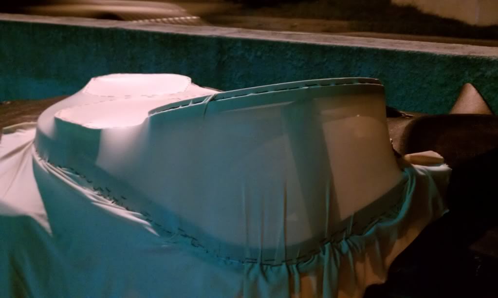

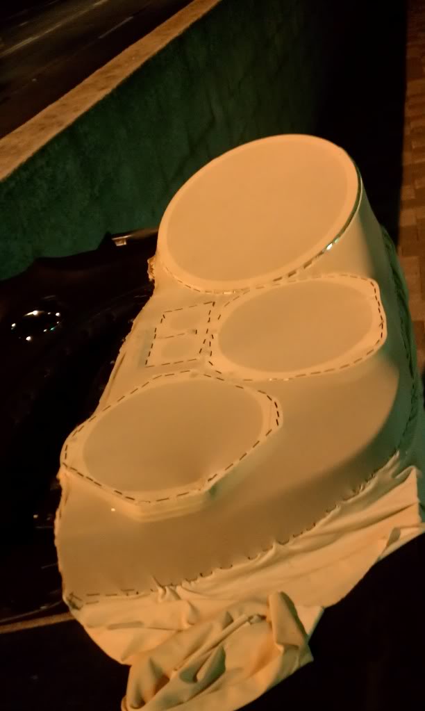

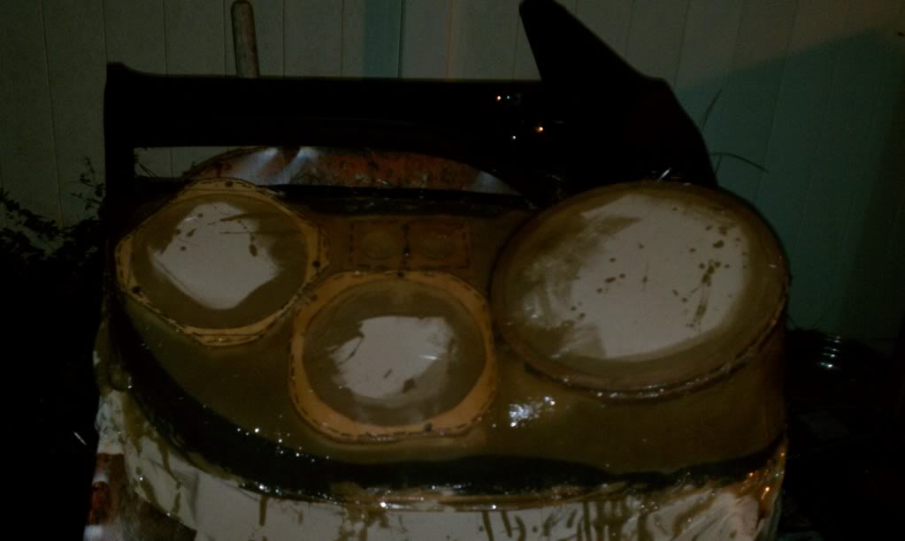

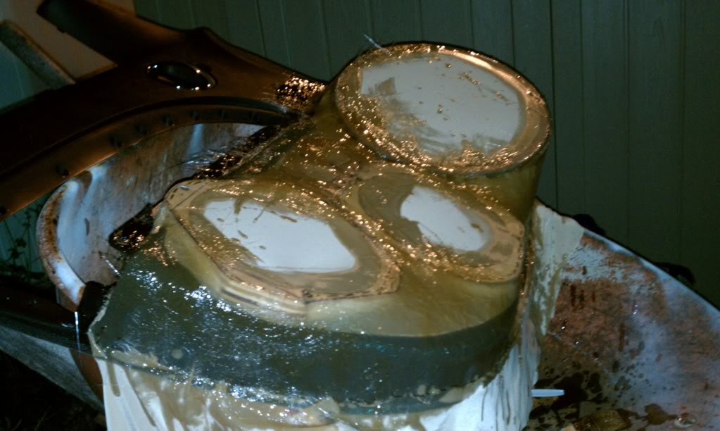

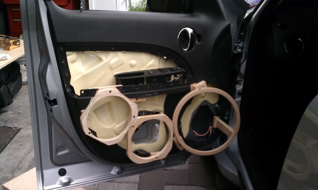

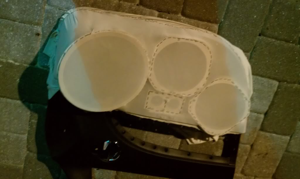

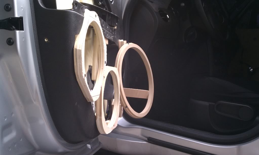

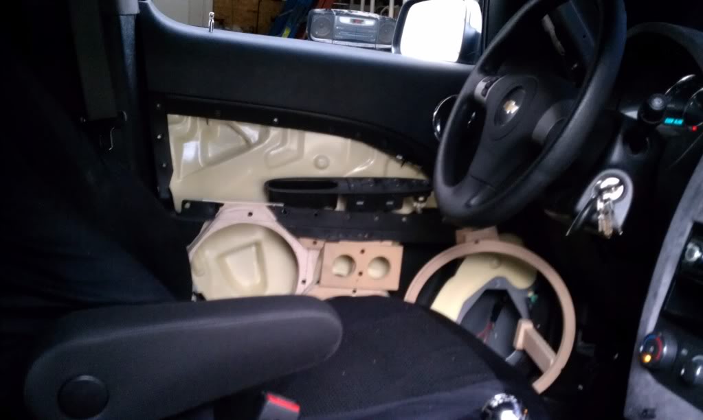

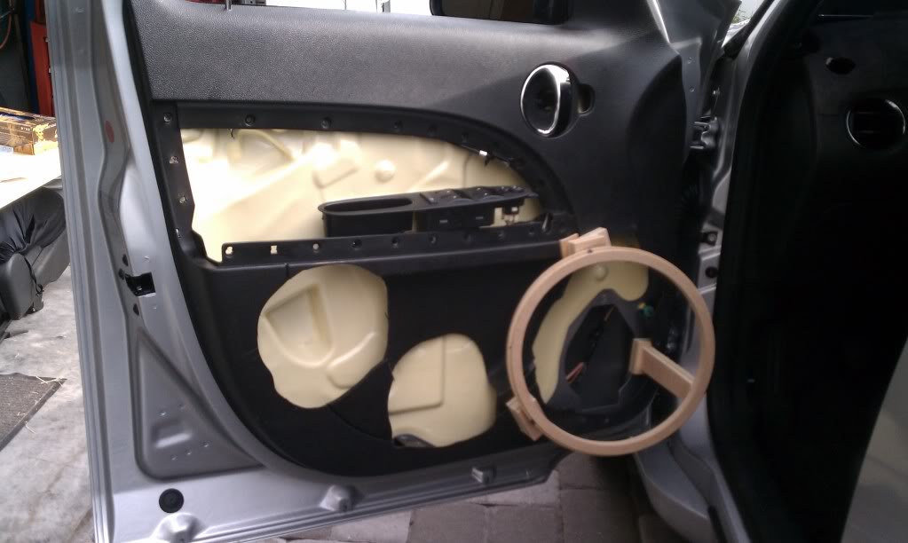

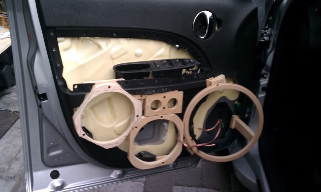

lil sloppy, i stapled it with the panel still on the door so it wouldnt flex out of position.
then i took it off and resined and added a thick layer of mat in most areas, some 2 layers (under the 12 etc),,,tomorrow ill trim it up and start sanding and prally add one more layer of mat on the back side for re-enforcement. cant wait to have these things playing!!!!!!!!!!
oh and all the sharp edges from the baffles under the fabric will be filled with rage extreme, so it will all look nice once i complete the body work.

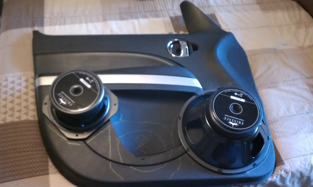

Did you just put a 12" driver in your door?
