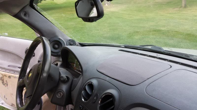

But on the other hand.. I didn't quite get done what I wanted to on this, today. I did get my crossover components in to assemble my crossover. I'm simply experimenting with this center channel to see if I even like it. On with the pics.
I then decided to redo my pillars.. I think I'll like these much better..

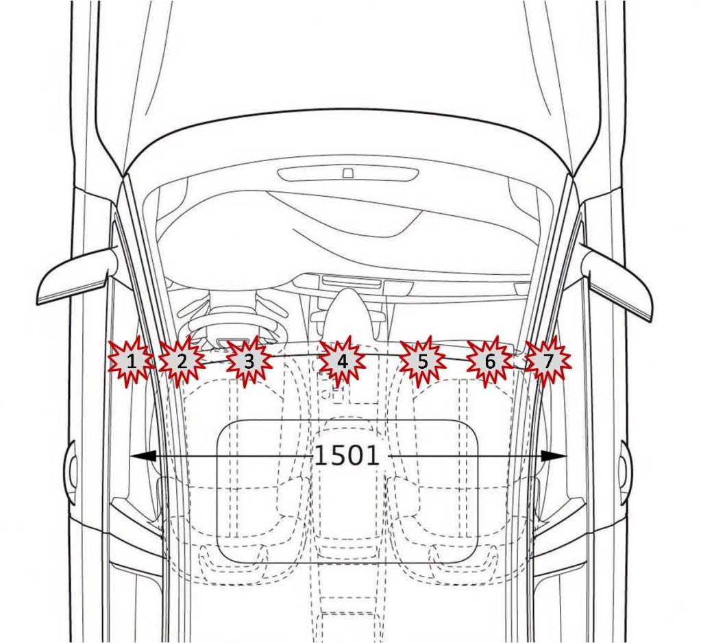

Do you have the seven snare drum track from Iasca? I could never get it to play flat across the dash with my mids and tweets at that angle. Hopefully that was just mine and won't be the same for yours. I have a friend here that also has an HR with dash mids that has a lessor issue with this but it is still there. They always wanted to play the center behind the rearview mirror and would then come down to the mid location at the ends. No matter what I did I could not get the center to come down to the same level as the other hits. Moving my mids down to the kicks I now have no issue getting my stage to play flat across the dash.
This is from above but imagine flat like this across the dash

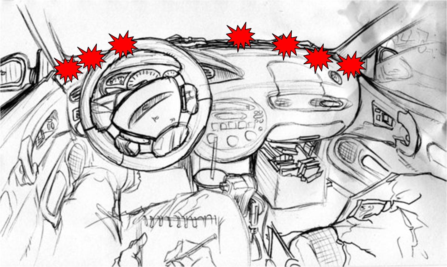

What I would get was more like this but with the center behind the mirror and the ones just to the side of the center heading up there too
