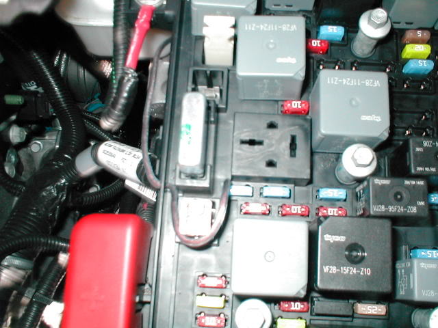

Originally Posted by SoCalHHR
I'm willing to bet your "engine whine" problem is coming from where you are pulling power from.
that is highly likely, I fished a wire thru the firewall and attached inside the main circuit breaket box, just grabbed any switched fuse.
I'll try this first as it would be the easiest fix,(i won't have to remove the HU AGAIN) because i will be re-wiring to fuse 21 in the passanger auxilary circuit box, like i should have in the first place.
