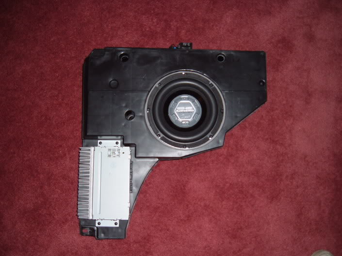

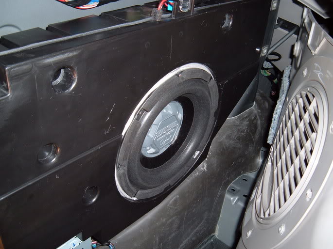

I don't have many but here you go:
I have to pull it out again this weekend so I'll snap some more shots for you Adam. It's not that hard to get it out but it's a pain in th a**. You have to pull out most of the panels in the back in the middle and drivers side. The lower panel that hides the sub is locked into the panel above it surounding the back window. The factory box is very shallow and the factory sub is bolted in to the back of the box. Of course that's after I put the Audiobahn in the box, you don't really want to see the ugly crap factory sub.

k a few questions ..agian :) Does the box come if you dont get the upgraded sound system ( i would guess not) Is there enough room on the other side to do it exactly like it is where the factory is. If it is i could fit 2 8's or 10's one one each side and mount the amps next to them. That'd be perfect If I could do that.
Old Feb 1, 2006 | 01:09 PM
  #27
captain howdy's Avatar
Joined: 10-14-2005
Posts: 9,121
From: Rochester,N.Y.
The box is only in the premium Pioneer system to my knowledge. I have never pulled off the other side panel so I dont know how much room is behind it but I would imagine a little less seeing as how the fuel fill is on that side. You don't have that much room to play with. See the size of the factory box in relation to the sub. That is exactly how much room you have. The box is shoehorned in there with no room to play with. The box fills every posible inch of the back area, from the wheel well to the window and from the tail lights to the back seat. There isn't much room in there at all! You'll also notice that the box is shaped like the wheel well.
