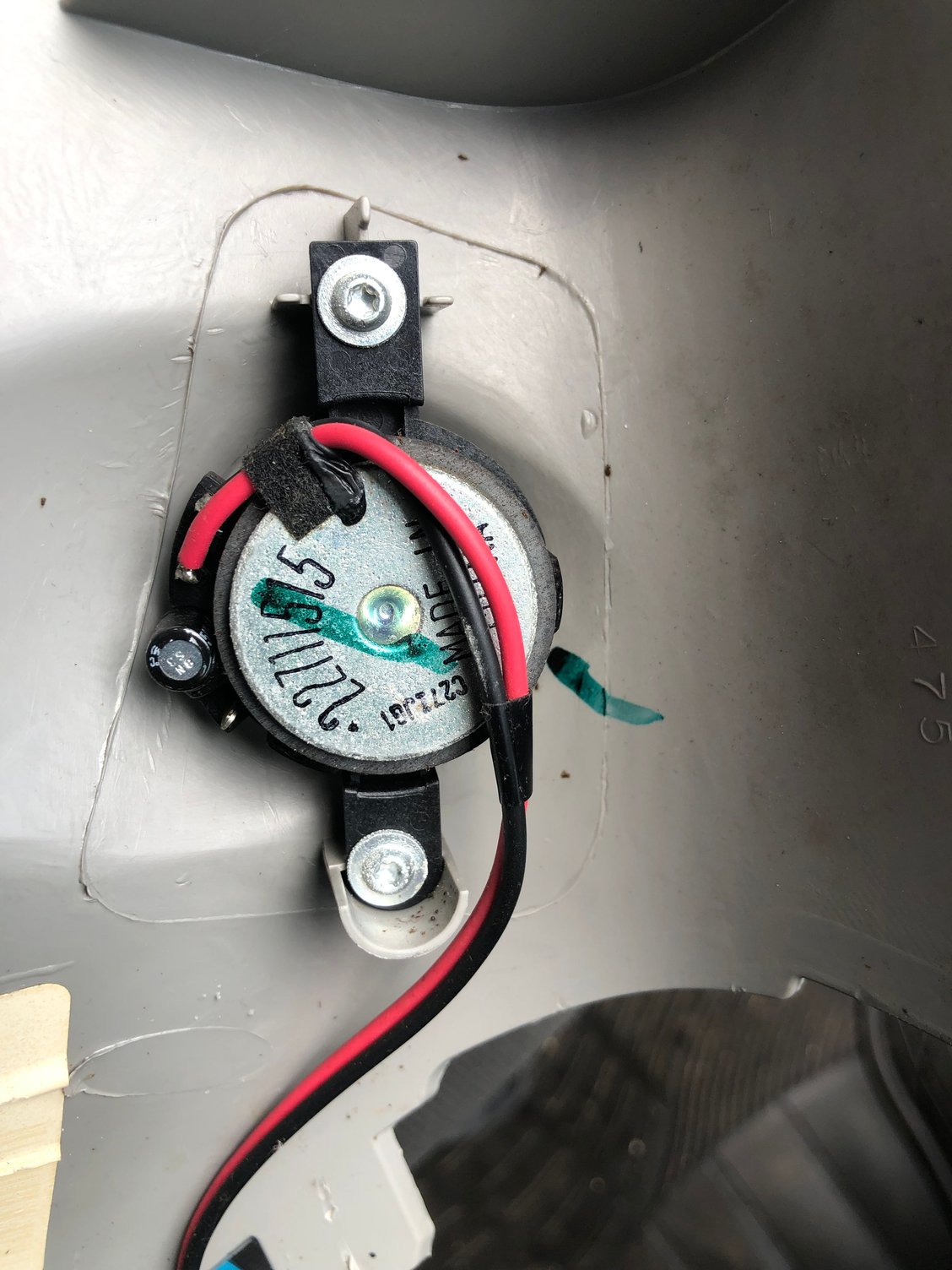

Old Jul 4, 2023 | 10:12 PM
planetrj's Avatar
Joined: 01-31-2020
Posts: 312
From: Hilo, Hawaii
Is this the actual stock tweeter?
I’m pretty disappointed with GM for using these to be installed for a Pioneer head unit.
I’ve since replaced the stock unit and door speakers, but I just had a chance to see the tweeters, and I have to say it’s very disappointing to say the least.
Looks like 2 inch max speakers are possible, based on the measurement between screws.
Does anyone have a good recommendation for replacements with a specific brand/wattage/ohm >< as it seems that these are set up with (perhaps?) an unnecessary suppressor built into the oem tweeters.

I commented on your other thread but I too am getting ready to replace my tweeters.The stock units have a 2.7 ohm impedance so you will want to get as close to that as possible .If you go higher you will want a sensitivity above 90 dbs.I have chosen these as they are 3ohm and I already have Infinity speakers in the rear doors.Not that brand matters all that much.
https://www.crutchfield.com/p_108R37...REF-375TX.html
They are cheaper on Amazon but I can't get conformation on whether the crossover is included which you will need to install.
Amazon Amazon
I may just grab them from Amazon.If they don't come with the crossover I can always return them.(penny pincher)
