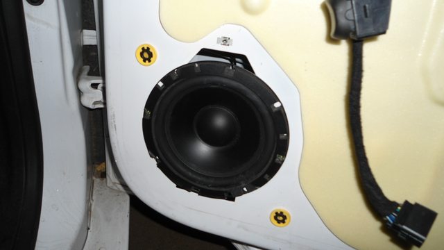

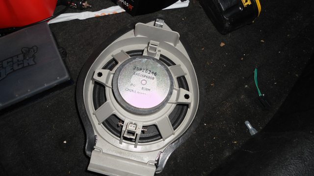

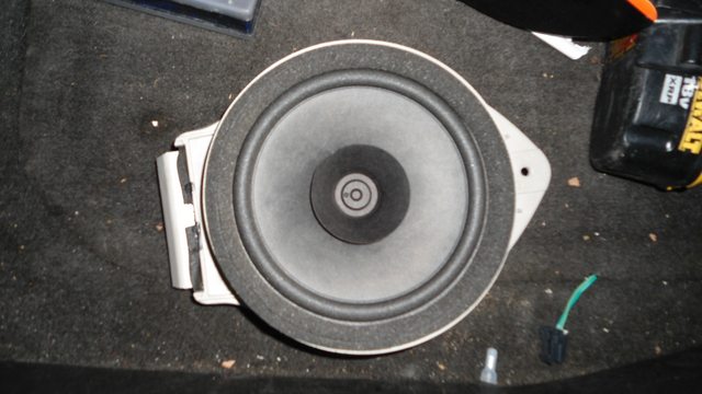

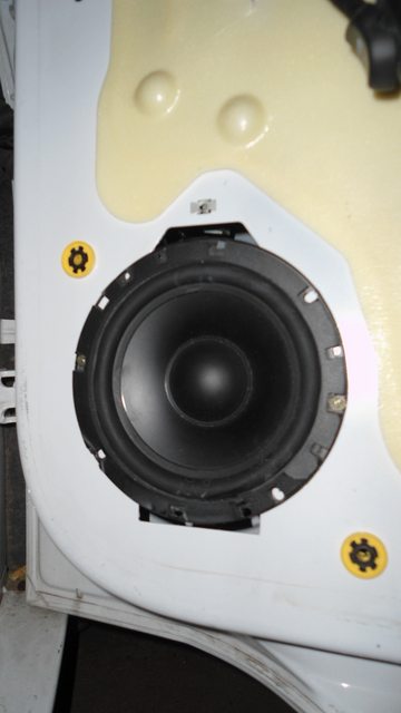

Going to try cutting out the stock woofer inside the mount method tomorrow. I was not happy with the way I came up with today. I think the stock mounts are sealed for a reason :p
I'm almost tempted to leave these in since they sound pretty decent when you put them on an amplifier. Too bad they are 8ohm
