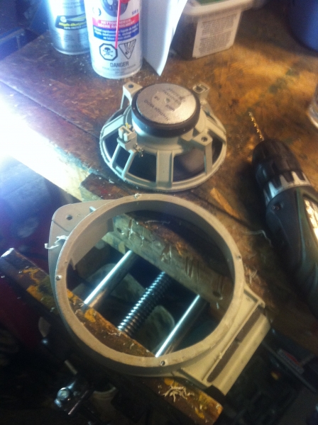

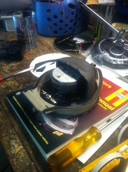

Here's how my adapters turned out. After cutting out the basket, I cut the front lip off to get the speaker to sit flat and drilled pilot holes in the adapter. The screws went in on an angle. I went with JL Audio speakers - C2-650X in the front and TR-650-CXi in the back. The half foam baffles are intended as drip shields. The speakers sound great. I originally used whole baffles and found the bass was fuller with the half baffles.

1. I only trimmed the mounts - no added material. There was a lip on the front that I cut off flat to the face. It is important to know that the rear mounts are about 1/4" thicker than the fronts. This may give the impression of added material.
2. Correct - the baffles are rain hats only. While I did not see evidence of water damage, they're cheap insurance.
