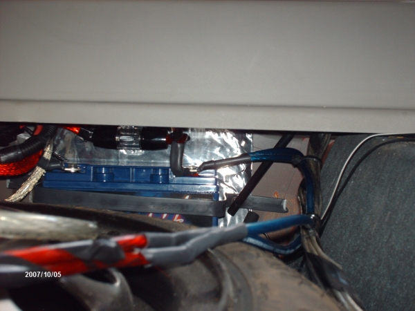

The Kicker shot craps; keeps cutting out. Thankfully it has about a month left in the warranty. Gonna have an extra battery added at the same time so my headlight quit dimming at night.
BTW, Navyflyer, finally got that new box of mine to thump. When they were checking out the amp, they re-tuned everything for the new box. Sounds great now. Got another car-shaker!
Well the new amp works fine and the re-tune of the system has the windows shakin' again.
The added battery seems to be helping with the headlights dimming too. Very clean install. Nice plus-still got my spare tire!

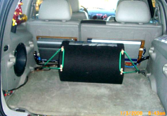

Here is how I did it. Plenty of cooling for the amps, they are out of the way for storage, look good at car shows, but hard to see through the tinted back windows. Stained plywood was mounted to plastic panal behind seat, which made it easy to attach amps, wire hold downs, fuse and distribution boxees, etc. Sub is Kenwood 10 inch mounted in enlarged stock location, with 3/4 ply behind panal as backing and for secure mount. Entire cavity is lined with Dynamat, and foam is used to reduce airspace. Bass is pretty good. For added sound, tube with matching speaker can easily be added with banana jacks and speaker plug mounted on side. Modified bungee cord with just one hook on each side hold securely. Amps-Blaupunk 400 watt mono sub, and old Alpine 160 4 channel (needs to be replaced with ?). Four Rockford Fosgate 6 3/4 in doors, stock tweeters, and Pioneer DEH-P9800BT head complete the system.
Four gauge monster cable for power and ground each to a distribution box, then 8 gauge to amps. 14 gauge speaker wires go to harness in rear where old amp was. Left slack so each seat can still fold down. Ground is to large bolt under storage compartments. Still searching for nice sub grill.

All that and storage too
Seriously though, it looks good and you still have room left over. Did you have to use the plywood on the seat backs though or could you have just screwed the amps to the seats?

The plywood was actually very easy to install. The plastic seat back hooks on, and 2 small screws are used just to keep it locked in place. Remove them and the seat back lifts out. I drilled holes in the plastic and screwed the wood in from behind. The plywood makes a perfect base to attach all of the stereo components. Otherwise, screwing into the plastic would not have been as sturdy a mount for the subs. Plus, the wood insulates the plastic seat backs from the heat. And it only adds a little thickness.
