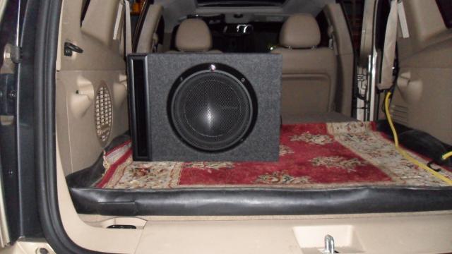

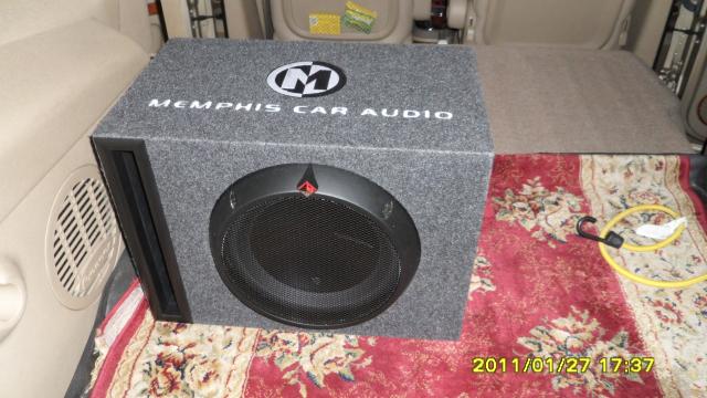

Thumbs up ported or sealed
In my opinion, a ported sub will perform better playing acoustic bass.(bass guitar or big ass bass fiddle) A sealed unit is better suited for "mechanical" sounds such as drums,ect. This is a pic of my 10" Rockford -Fosgate in a Ported box. It's all I need(at 900 watts rms)

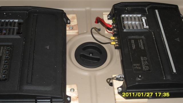

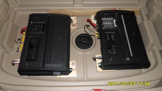

Andy, Check this amp install out.Kenwood 4 channel on the left, Kenwood 900 watt RMS mono on the right. This way they are out of sight, and I can STILL get to my spare without problems. (I used the Kenwoods because they both have cooling fans)
