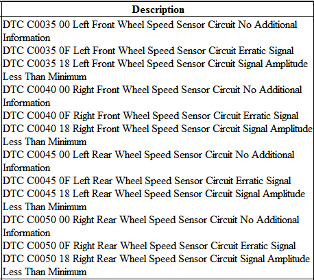

One complete assembly of what?
Did you check the wires from the WSS to the EBCM?
What error code? Drv.rear means nothing to anyone but the programmer of the reader.
Old Apr 11, 2017 | 01:00 PM
Posts: 26,533
Testing the resistance of a Hall effect circuit does not tell you much.
The output is a voltage when the wheel is spinning.
