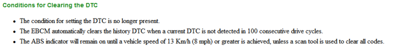

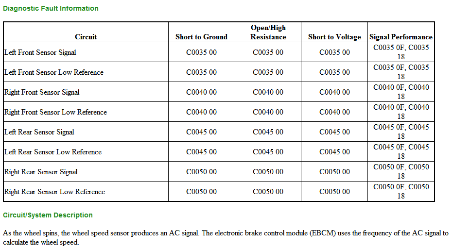

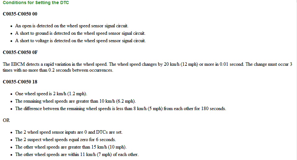

Old Apr 11, 2017 | 02:16 PM
Posts: 26,533
The last hex digits are important. 00, 0f, 18. but that doesn't really tell an amateur much.
Did you check the wires and connectors on both ends. That is where your ohm meter would tell something.
ABS / TC lites on then off-abs-fault.png
ABS / TC lites on then off-abs-cond.png
ABS / TC lites on then off-abs-clear.png

I can read and convert to and from deci - to hex or bin..... what are you referring to ???
Old Apr 11, 2017 | 03:00 PM
drad's Avatar
Joined: 12-15-2014
Posts: 13
From: Nevada
I wish I would have seen this 00, 0F, 18 hex .... I would have paid more attention the to reader.... right now I don't even know that those hex codes were there on his reader... great information thanks again

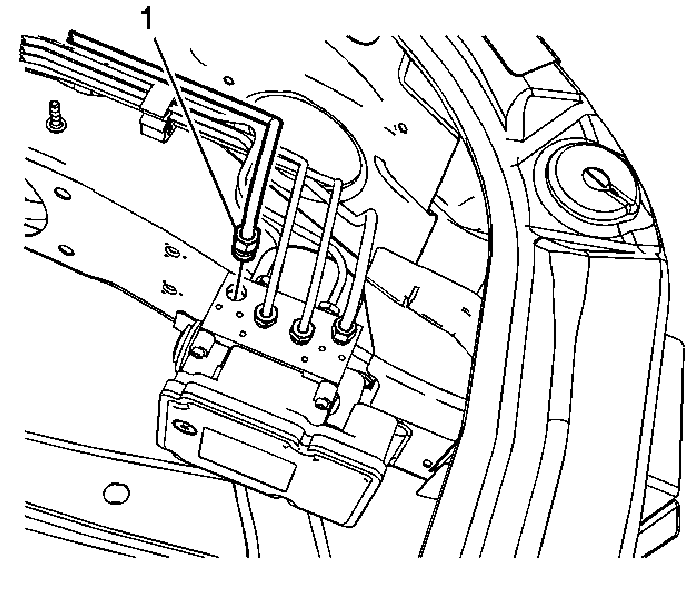

Old Apr 11, 2017 | 04:25 PM
Posts: 26,533
It is that box in front of the fuse box and computers with brake lines.
If nobody has been messing around under the hood (including varmints) I would just look for damage under the body and connector.
