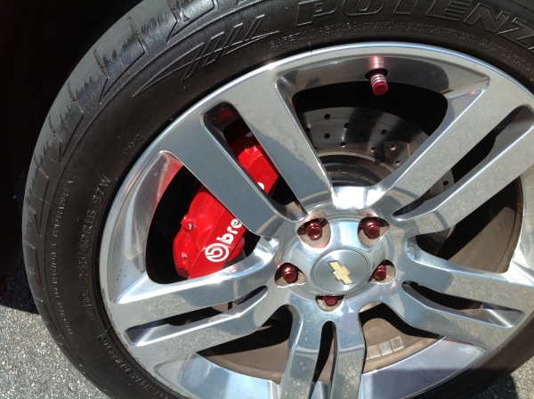

https://www.chevyhhr.net/gallery/fil.../8/0/image.jpg
Here is a picture of the finished product
