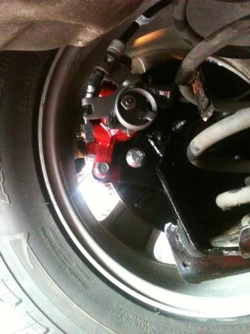

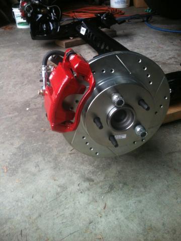

I am in the process of manufacturing weld on tabs for drum to disc conversion. All you do is have them welded on , drill two holes for the caliper and your done. I have six sets out now. Only one problem, as I said you have to have them welded on, by a professional welder. Not by a 110v stick box. Welding is around $75. I will be selling tabs for $200. They use all stock cobalt ss hardware. The bolt on type, some use GM calipers and some don't. So replacement parts can be tricky. Bolt on ones also move the rear hub outboard 3/8 of an inch and move the axle load to the 4 bolts, instead of the hub flange.

Okay been holding off with the NON-Brembo front brake and SS rear beam disc brake conversion. mods, things just pop up. Anyway, looking at buying new rotors for the mods. What rotors/pads would you recommend? Seen some sets on e-bay, was told about AutoZone. Slotted, drilled hole, dimpled, stock surface........?

Hey Phrog fixer, I had the cross drilled before i made the switch to Brembos, i had cross dilled and slotted on past cars and dont like the slotted, i think there is a little vibration and noise with them, cross drilled came on both of me Mercedes from the factory, they keep the rotors cooler in my opinion and provide a better feel in wet conditions.. that being said, make sure if you go the crossdrilled route, you buy the ones with holes everywhere, once again, my opinion from experience.. dont forget, keeping the rotor cooler provides less fade and will keep it from warping longer..

Glad you posted where you got the rear discs. I've been wondering whether the RDBs and/or axle from the Cobalt would fit.
Also, if you haven't done it it yet, the Cobalt Stainless header from Amazon is a direct replacement for the non-turbo HHRs.
Old Jul 5, 2016 | 03:45 AM
  #90
Frenchy42's Avatar
Joined: 12-06-2013
Posts: 540
From: Everett, Wa
The Cobalt axle is a direct fit. I used the one from a Cobalt 2.4 SS on my LT. The entire exhaust from a 2.2, 2.4, or 2.0SC will also directly swap, as long as it's the same transmission. The only difference is the tailpipe on the Cobalts sticks out about 4-6" past the HHR bumper, so you have to section it, and there is one hanger on the muffler that needs to be moved. Everything else from exhaust manifold to the muffler bolts right in.
