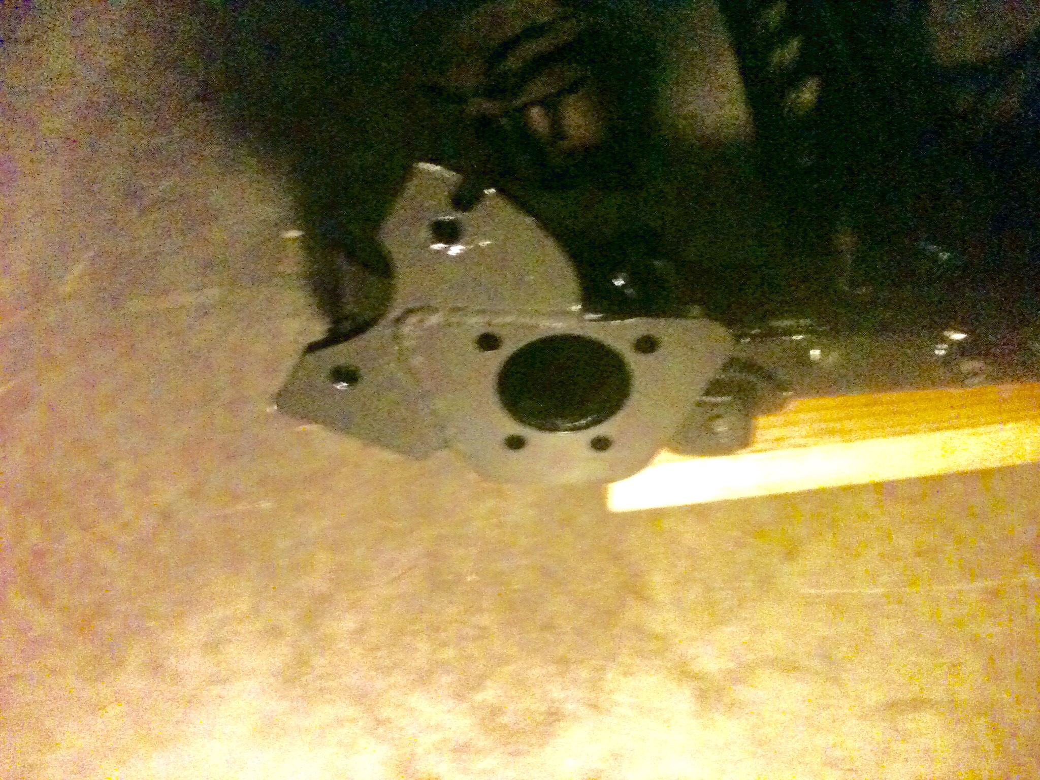

You could just get a piece of 3/8 steel and cut it out to what you need and weld it on to your axle. Scrap steel will cost about $20.00 you can cut it out with a torch and grind to fit, or bribe a buddy with a water jet to cut it out. I had them welded on for $75.00. As you can see its not very high tech to modify your standard axle to install disks. Done it 20k ago works fine.

RF2, that is a great solution if you have a welder and can weld properly.. do you have dimensions/blueprints if any of the users want to give it a go?

If you PM me your address I can send you a cardboard template. If you can weld, use transfer punches, and grind you can install these. All the stock "SS" rear disc parts bolt up. You will have to get rotors, calipers, and the dust shield to set up for welding.
