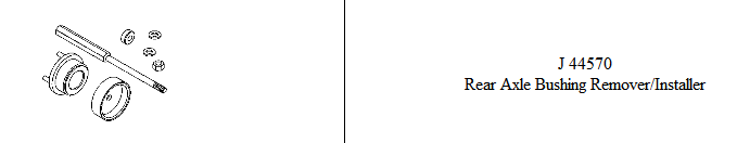

You can borrow a tool from Advance/Zone.
Name:  rear bushing tool.PNG

X2 with car-parts. ebay is also useful. I found my axle beam in St. Louis. Bushings and hubs - MOOG, brake discs, pads, rotors - PowerStop, brake lines, parking brake cables, hardware - Raybestos. Total cost of $850.00 plus time to install. Oh, and $200 for bushing tool J44570, which I now have and will let others use for the cost of shipping.

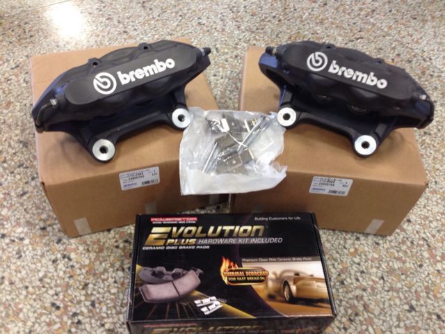

HHR 2011- does the same caliper bracket work for the larger rotors used with Brembo s
Originally Posted by American & Proud
Pics of the Rears and a HOW-TO !
I tried buying an SS rear axle but the junk yard never sent to pics before I drove the 200 miles to go buy it, so I moved on to other projects.
The Supercharger is going in before I add rear disks now.
But a good how to with part #'s included would be very cool if you did it without buying a SS rear axle.
Fronts look good.
Does the bracket used for regular SS brake caliper also work with Brembo caliper and the larger brake rotor setup?
Old Jun 2, 2018 | 04:48 PM
  #128
Posts: 40,083
In a word no
SS caliper brackets non Brembo
Brembo calipers, you’ll need new brake hoses
But don’t be shy, go big!
14.5 inches diameter rotors, tuck nicely into 18” SS wheels
https://www.ebay.com/itm/ZZPerforman...3635746?_ul=CA
These look awesome
