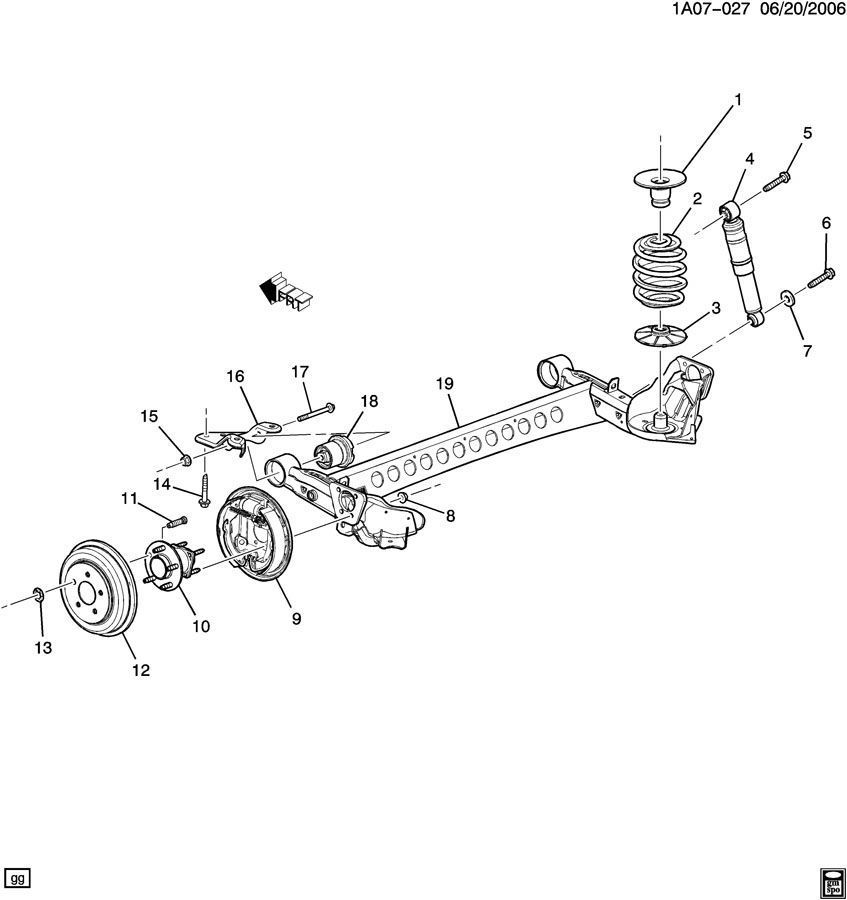

So I brought the car to a mechanic to change the O2(Upstream) sensor and while it was on his alignment rack I pushed the rear wheels and seen the axle bushings moved a good 1 to 2 inch. So fingers crossed I will reppace them and hope that solves the issue.

So I just wanted to update the thread if it happens to anyone else, the mechanic replaced the rear axle bushings and it solved my issue, no more wandering on the road. The bottom of the rear 2 coil springs was broken as well so he replaced them. Thanks for all the help
Just an fyi for anyone who wants to attempt changing them, if you live in the rust belt like me it's one heck of a job. The whole rear axle had to come out of the car and since there's no room to remove the axle bolt, he had to remove the axle brackets from the bottom of the car chassis. Then the nuts that the bolts of those brackets bolt on to the car are only spot welded from the factory inside the chassis, so when we went to remove them that nut was free spinning inside the body. So the only way to get at that nut is to remove the back seat and cut a hole in the sheet metal to get to the nut. Then remove the bolt and re weld the nut in place and and use a new bolt. Basically it's almost the same thing as this guy went through in this video:
So if you live in the south, it might be easier but if you live in the north, think twice before doing the job in your driveway.
