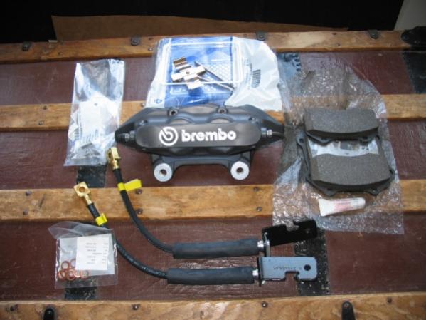

I was looking on GMPD and found the brake upgrade, I think, it is listed under the cobalt section in the catalog, is this the bembro upgrade? if not what is the kit #?

If you get decent over the counter price from your local chevy dealer, (or use gmpartsdirect.com) figure roughly $850 for everything. Shipping is significant. You can run some prices at gmpartsdirect. Calipers 25900763 & 764, pin kit 25900781, pads (includes 4) 25808929 or Ferodo 107.8954.50 (uses HP1000/1 friction mat'l), copper washers 21012386, hoses 15939642, banjo bolts 11569669 (pn might have changed recently). Bear in mind that while I am told (and believe) all this will work fine, you order and install at your own risk, and obviously Chevrolet would not warranty any of this.
__________________
ORIGINALLY POSTED BY: c2vette
Well, it only took an hour to find it but here is what I could find for the rest of us...
The Cobalt SS rear brake upgrade is not Bembro's but larger and ventilated, the parts are listed in GMPD's catalog for Cobalt ss.

although I guess it was determined the GMPD was referring to rear brakes?
