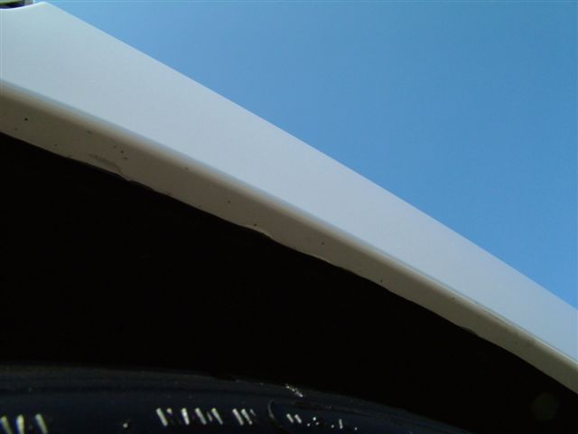

Rear wheel wells have been trimmed. I used a snap-on air saw blade and trimmed 15mm or about a 1/2 an inch. Took about 15 min a side then sanded smooth and used 3M undercoating to protect the exposed metal. She drives the car daily and no rubbing what so ever if the wheels rubbed I would be the first one to pull them off. I will take some pictures of the rear tires this weekend and I believe she has put about 3k miles on the car since. Thanks

Trimmed Wheel Well.........
Larry, here is the picture you sent me............

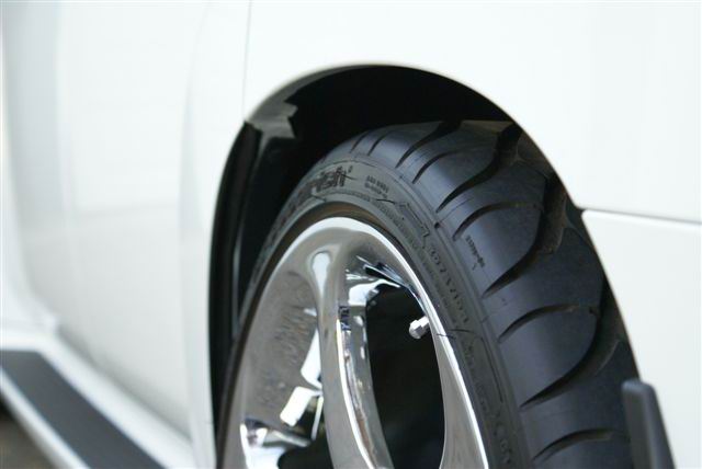

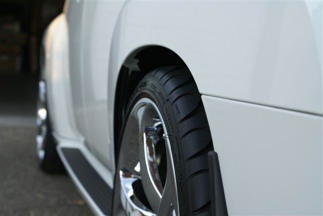

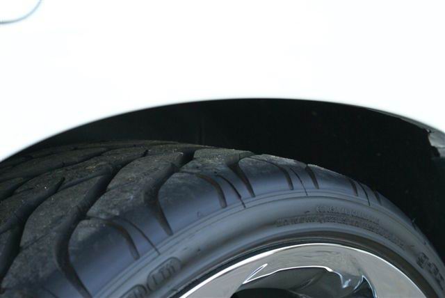

Here you go SOCAL!
I took some pictures of her car today, 2800 miles have been put on the HHR since the lowering. Sorry for the quality of the pictures but I used her camera. The car is driven daily and has had 3 people at one time and no rub marks on the rear tires. If i had not trimmed the rear fenders the tires would have been cut up pretty good. Here are some pictures of each side.
