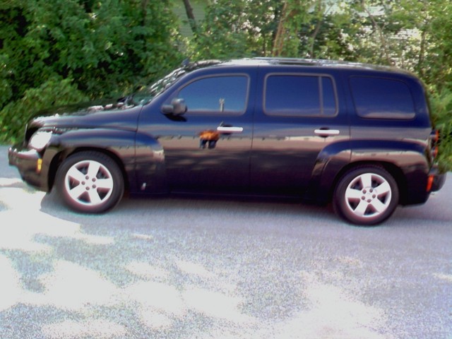

Anyone got pics of this lowering kit with stocker polished wheels and stock tire size ?

Here is a picture (sorry about quality) of the Eibach kit with the factory LS wheels and tires. It might even be a hair lower now than in this picture, because this pic was taken about 5 minutes after kit was installed. At least you can get an idea of the wheel well height. The overall diameter difference between the 215/55/16 (25.31") and the 215/50/17 (25.46") is really minimal so the only difference is the stocker hub caps vs. the polished wheels. Hope this helps somewhat.............Regards
https://www.chevyhhr.net/forums/atta...1&d=1157383729
