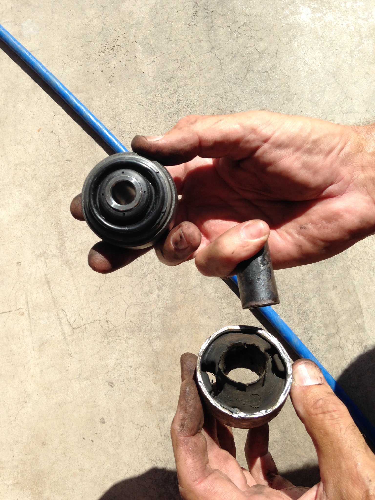

Cat Man HHR, the Moog folks didn't test them so they don't list them!
The Moog K200792 bushings fit the FE5 aluminum LCA's, the same diameter as the FE1 and FE3.
The Moog problem solver LCA's do not include the bearing bushing!
The Moog LCA's do not fit the FE5 ball joints!!!
If a picture paints a thousand words!!
Left is the K200792. Right is the OEM bushing I replaced just 61,000 miles before!

After your answer to my PM I looked up Cobalt SS and it said the K200792 fit.
By the way when you take a picture please clean your hands, this is a family web site :)
And stop with the !!!! :)

I'm a hands on kinda guy! I was in the middle of the bushing swapout!
My makeup personnel assistant was gone for lunch!
The director and our cameraman were impatient!!
