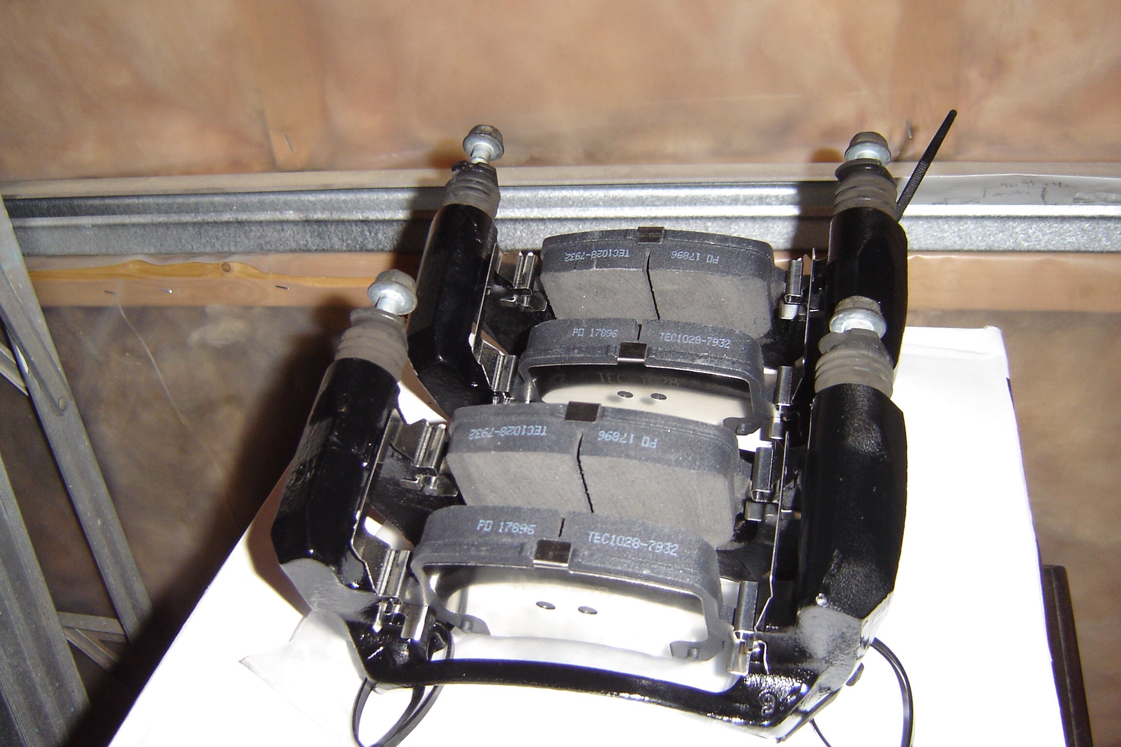

Posts: 40,083
My caliper bracket bolts are a 15 mm six point hex head bolt, these are the bolts I undo to remove the caliper bracket to remove the rotor
My caliper slide bolts are 14 mm six point hex head bolts these are the ones I undo to remove the caliper and get at the brake pads
