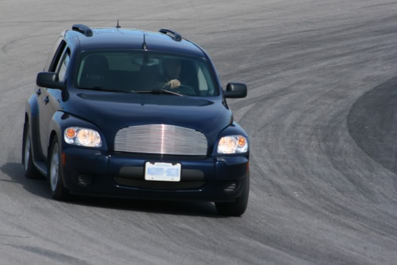

I have the FE1 front bar with a progress rear bar, CM springs which are a bit stiffer than stock. In the following pic of me on a banked short oval track, there appears to be more roll on the front than at the back. I thought a stiffer front bar would help, or as some have said, would it reduce traction at the front?

I address this in the above post.

A bigger bar will only push if you are already at the limit of bar size ( or have really really crappy tires on the front )....factory cars are purposely undrsized so a push happens as this is the easiest to control for the "average" driver.....the reason the front drops so far and the rear raises is BECAUSE of too much body roll....more spring and /or bar would correct this..these cars dont have a whole lot of flex .. at least nothing to worry about for a street car...nothing like the older cars..if they flexed that bad the windshield would pop out, notice it has no real retention clips..just glued in. As said theres no over the counter bar that will cause any handling problems unless your system is worn out....and be careful what you read, alot of the printed info is vehicle specific and may not apply to this platform....as people start experimenting better tips and tricks will evolve.....too much rear bar is bad..the weights up front.
