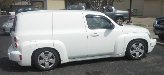

CJNAPPA, I just got your pvt message. I had the KSP-LSCV04 springs on my 09 LS Panel for about 6 months. I have since sold the HHR & still have the springs in my garage. These springs worked well on the front of the HHR, but on the rear they maxed out the rear shocks a bit too much and would "bonk" over medium bumps. I set of shorter rear shocks should fix this. Other than than, they worked very well. Not too stiff, and yet dropped the car quite a bit.
Here is a pic I snapped right after installing them, the front settled in a little bit more after this pic & no longer looked higher as it does in the pic.
