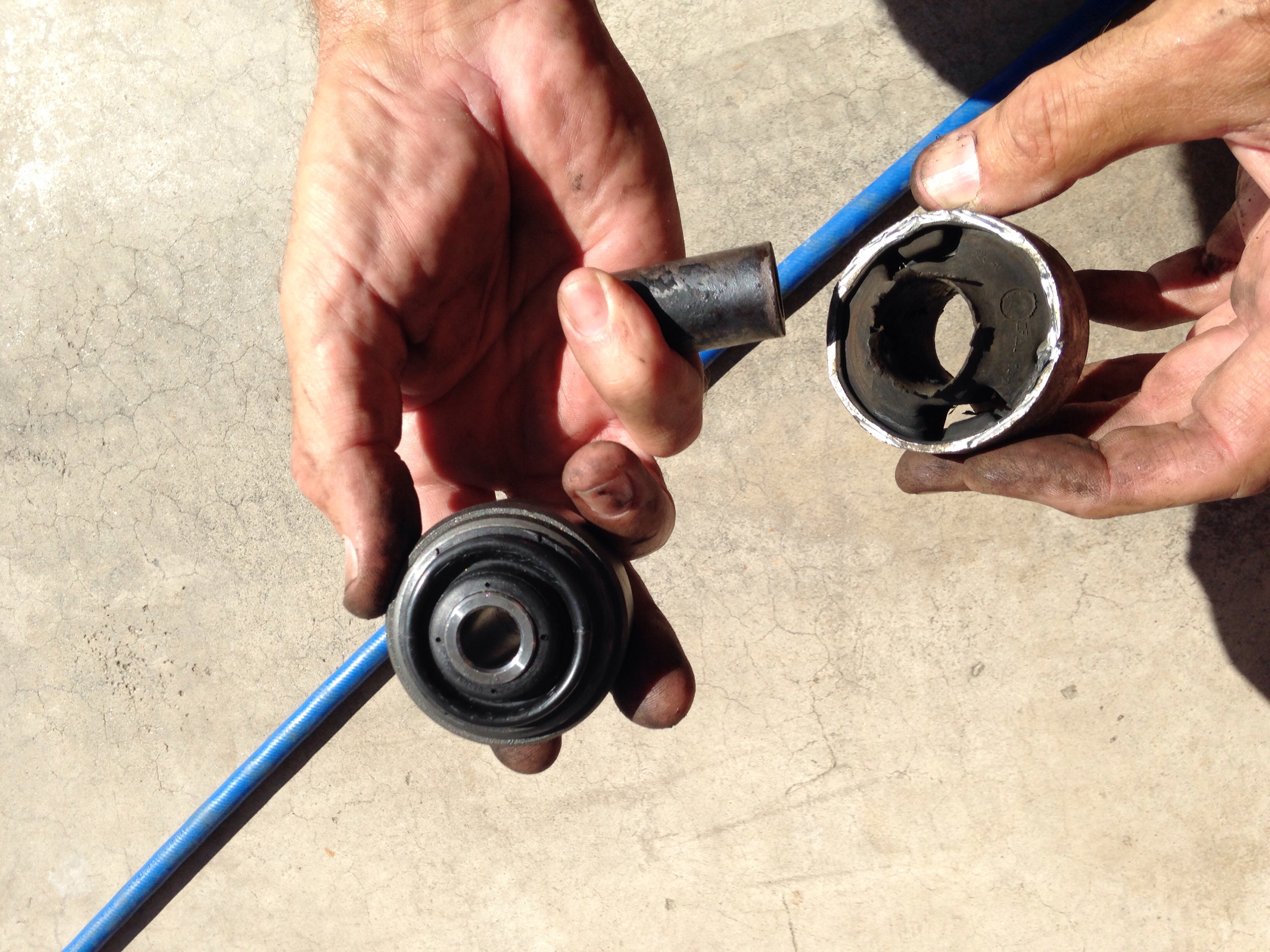

Are you sure it's the rotors and not the LCA rear bushings or maybe ball joints or tie rod ends? I just fixed my brake judder, with new LCA bushings, I have the non Brembo SS rotors on my LS.

Could be the rotors, mine was a shake issue after a drive in the Smokey's along thru to Gatlinberg and Pigeon Forge, I upgraded to the SS nonBrembos, still had the shake, so next was the LCA bushings problem solved, that was 4 years ago, the last 2 months the shake started up again, Monday I changed out the bushings to the Moog problem solvers, no more shake!
