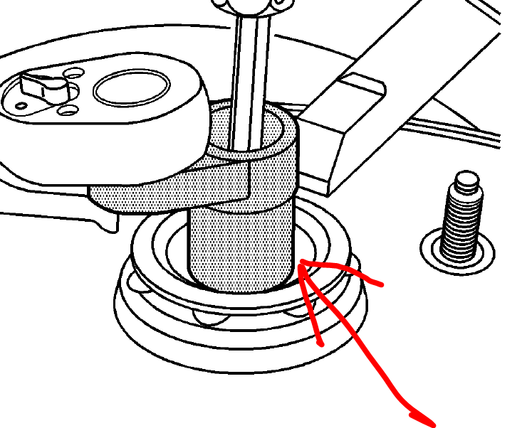

Yes, that is the nut. I installed them without using the special tool, just the hex wrench and a socket/vise grip combo on the work bench. I was hoping the problem was that I just didn't apply enough torque to fully seat the nuts, so I had the alignment shop check them. They said they did... but now I am wondering if they actually checked them at all, because for the life of me I can't figure out what else the problem could possibly be.
If I can rent or buy the proper tool, I will recheck them myself. Any suggestions? I am having a hard time locating one.

You don't really need the tool. I have used an impact gun, like most shop techs do.
I think that socket is the same as an O2 sensor socket.
1/8 inch should be noticeable thread exposure.
Did yo replace the strut mount/bearing, if not did the old one fall apart and a part forgotten?
The next question is not meant to be a slight. Did you remember to take the spring compressor off?

Thanks for the info. Interesting note about the thread exposure... there is barely a thread showing on each shaft after the nut. The OEM struts I took off have about an 1/8th inch as you mentioned. I noticed this difference when I assembled them, didn't think much of it because the nuts were both as tight as I could get them. The thing is that the passenger side is the only one that has the vertical play, the driver side is fine. Hmmmm....

Any suggestions on how to properly tighten the nuts without the specialized tool? I've heard some people use a vise grip on the strut shaft while tightening the nut with an impact. I'm not too excited about risking damage to the shaft though. Any input is greatly appreciated.
If it is the right size O2 sensor tools can be "borrowed' from Advance/Zone/O'reilly. 7/8 rings a bell.
Use the vice grip on the end of the threaded shaft.
Use the vice grip with lots of padding on the shaft.
Use an impact gun.
I have used the last 3.
Use an impact gun.
X2 on everything DonBrew said above. A trick that has worked for me before is to install strut on car, lower car and then tighten the top center nut. Obviously get the nut tight enough to remove spring compressor before attempting. Sometimes the weight of the car will keep it from turning. 89 ft. Lbs I believe is the torque on that bolt.
