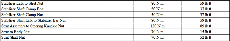

Posts: 26,533
Actually, here are the torque specs.
Attached Thumbnails KYB Struts/Eibach Springs Installed, Veritcal Play in Passenger Side Strut Shaft-struttorque.png
