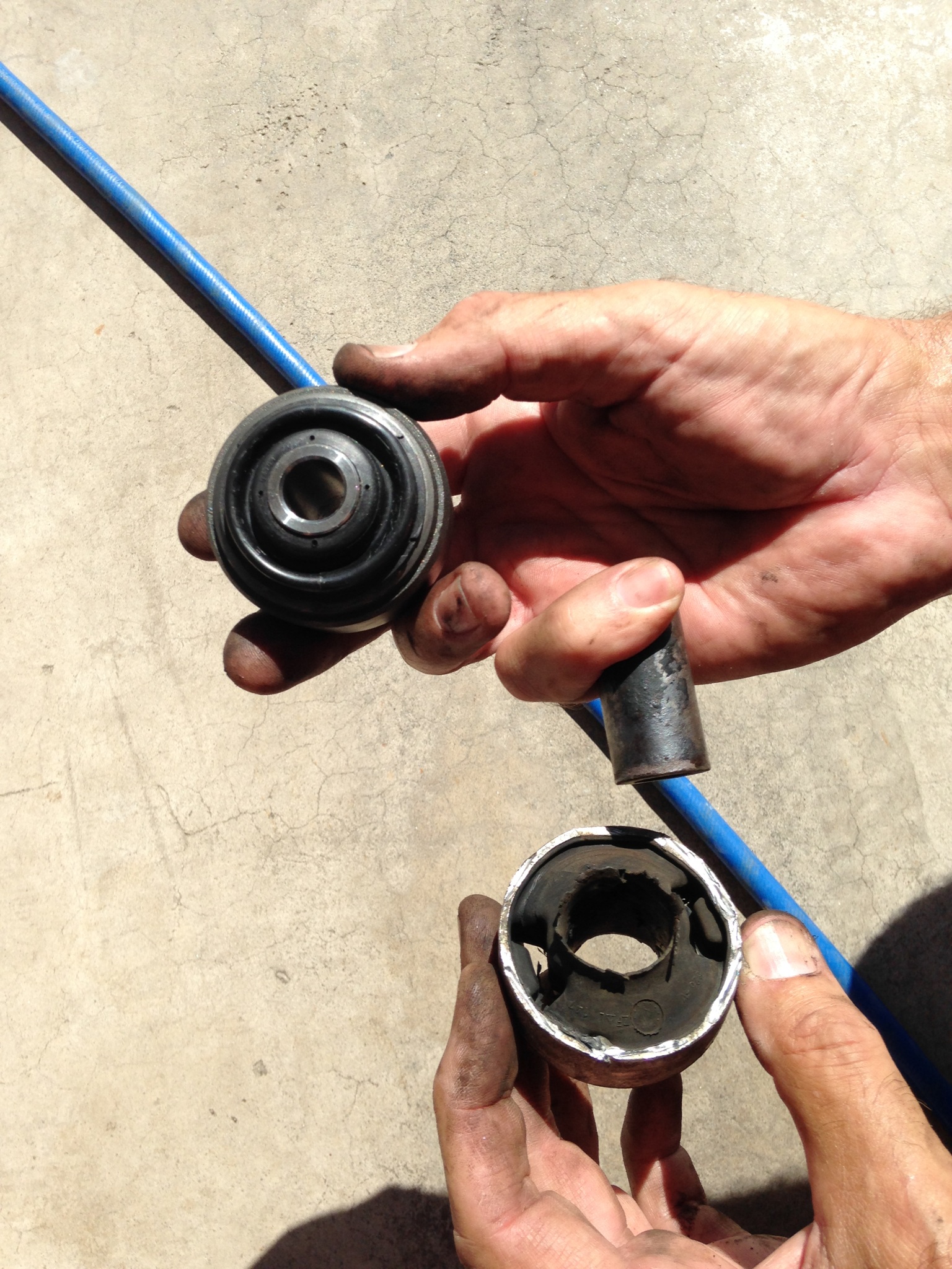

Go with the Moog ball joints and the Moog K200792 problem solver bushing bearings, I'm glad I did!
Attached Thumbnails KYB Struts/Eibach Springs Installed, Veritcal Play in Passenger Side Strut Shaft-img_0241.jpg
