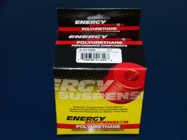

Here's a good thread on sway bar bushings for you to read over, I use ones made by Energy Suspension, there's a link to them in the thread.
Since you didn't specify which model HHR you have, you need to know the SS model uses 23mm bushings, while the LS and LT's use 25mm bushings.
