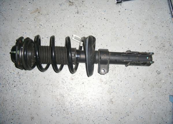

No marks to speak of Juan, but the proper relationship between the parts is obvious once you see the strut properly assembled. I've attached a photo of a properly assembled strut for your reference.
If you're allowed access to your HHR while they try again, check the spring positioning yourself, the springs only fit one way when installed properly. Please use caution if you do handle the springs while compressed, in the event of a failure of the spring compressor, you can be seriously injured or even killed.
In the photo, the top of the strut is to the left, just so you know. Hope this helps.

Well, I checked the springs, and nothing looks diferent. Actually looks like the picture that Mike showed. But the old hinge noise on the springs gave me a clue. I just add a lot of silicon lubrican on the top and bottom of the spring, and, lets say that the volume of the springs were reduced about 75%. Is an improvement, but the noise still there. I Remember that the guy who changed my struts didn´t grease the strut bearings. Then, the strut bearings would recreate this noise if aren´t greased?

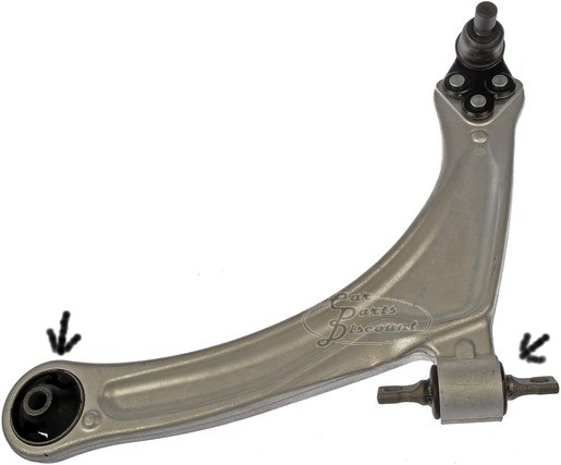

One thing you can also do when you're under your HHR with the silicone lubricant is to do the control arm bushings which are indicated by the arrows in the photo below. They might be dry or drying out enough to contribute to the groaning and creaking that you're having.
Thanks to share your wisdom with me Mike. I did it, and the noise still there
