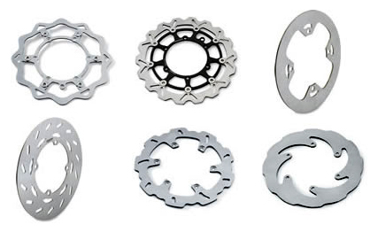

I ride dirt bikes & the brakes have come a long way. We started with drum brakes & finally got a disc set-up. Front only at first & then rear too! The first disc brake rotors were pretty crude. Large, solid & heavy. Eventually they figured out that they could save some unsprung weight by making thinner, smaller rotors. A rotor with drilled holes soon followed. The size & amount of the holes varied from mfg to mfg. Next came the 'oversized' rotor 'kit'. This was a larger diameter rotor & used an adapter to relocate the caliper. Soon after they started experimenting with slots. The trend these days is to cut metal out of every possible place. This creates the petal or wave rotor. The outer edge of the rotor is not round. It is cut out to save even more weight. Side note: In extremely muddy conditions, the high-end motorcycle race teams use an 'old school' solid rotor (round with no holes or slots).
