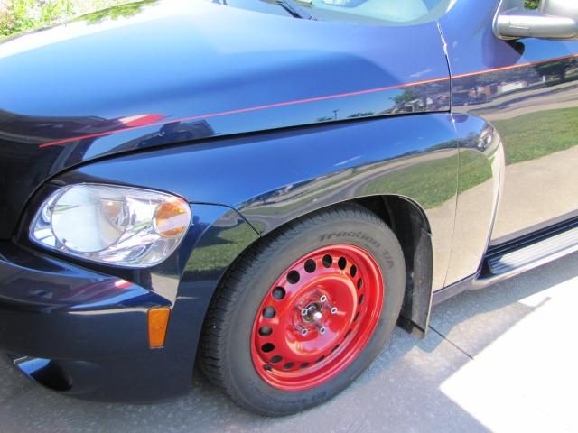

Old Jan 23, 2014 | 10:28 AM
Posts: 40,083
yes that is a consideration, and that is why I stayed with the 18 hole 16" steelies for the winter, what with ice and snow and salt chewing up the roads, and pot holes and train tracks, frost heaves, you get the picture!
