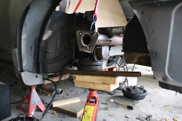

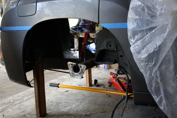

Here is what i have cut out. im gonna cut the entire spare tire pan and rebuild it

Why are you going through all of that work?

all the work? what else do i have to do? im doing it because the 2 link doesnt work well with adjustable suspension. i have wanted to do this for a long time just didnt have an excuse. that was until i pulled through an inclined driveway at an angle and bent the 2 link.
thats where the 4 link comes in. it will still be pretty stable but also have the flex i want. the front sway bar will stay.

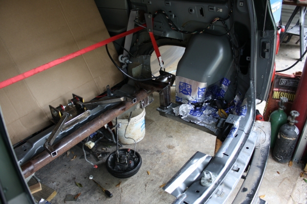

the upper bars are what you can see in the pic #2 they will mount to the xmember they are laying on up front and ill make tabs to mount to the axle. from front to back they are triangulated around 40degrees. the lower bars will be parallel and mout where the 2link did before
it wll lay out on the bumper in the back and should get decent lift. so i will be doing some crazy stuff to get gas into the tank and exhaust out the rear. oh yeah and also a built in ice chest for the car shows in the new spare tire tub.

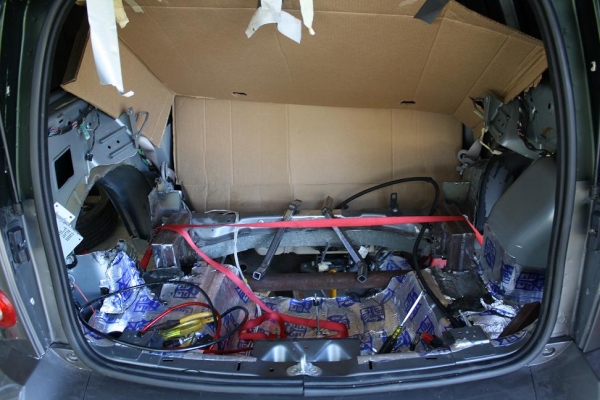

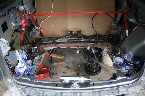

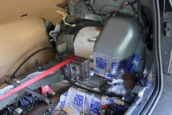

got most of the upper mount done and cut the rest of the floor pan out.
