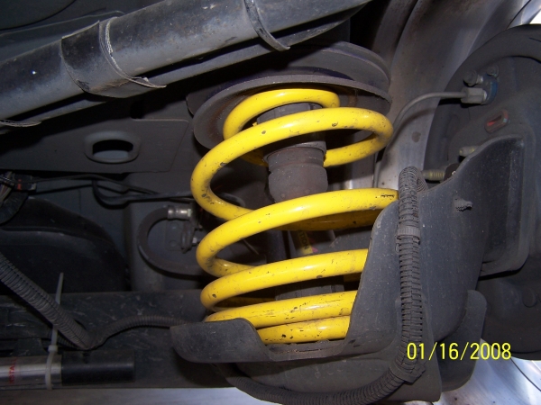

Okay I thought the original problem was a "thunk" in the rearend. I have noticed a rattle back there also shortly after I installed them. Is the tubing supposed to stop the ratlling noise also or just the thunking of the springs hitting eachother. Also which way does Goldline say they should be installed? Small coil upwards or down? I installed mine with the small coil on top (shown below) and have not had the thunk in my trunk just a rattle in back.

Yes the tubing is to isolate the coils that hit. Ive seen the Honda part and it is already coiled and split. I think I will try that as its inexpensive to try. Ive had mine out 3 times. 1st way, the Kahuna method, then flipped and that was REALLY clang-y. Took em out again today and you can see where they are hitting. Got some tubing from the hardware store, BIGGG CLUSTERSCREW. Decided to put em back in Kahuna Style and it's quieter. Still have the clunk going over small dips. I need to remove EVERYTHING to make sure.

I had the same grinding kinda bang on the right rear after putting in the gold lines.... I looked and ended up having one of the springs reversed ( still not sure which one, but they were in opposite each other) ...so I turned it over and viola! Silence......
