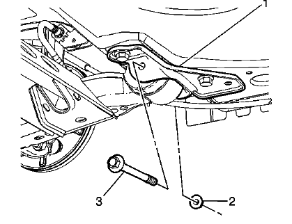

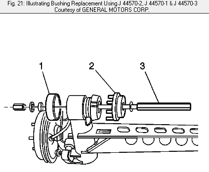

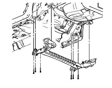

Old Apr 4, 2017 | 09:00 AM
Posts: 26,539
Size:  16.8 KBName:  rearaxle2.PNG
Size:  11.6 KBName:  rearaxle4.PNG
Old Apr 4, 2017 | 09:43 AM
Posts: 40,091
Let's K.I.S. , just the hubs for now, the rear axle beam bushings aren't going to cause a toe in problem, maybe a toe in and the other side toe out , but let's stick to a plan. As suggested.
Are y'all changing the hubs? If you have ABS be careful of the wiring harness connections!
Old Apr 4, 2017 | 09:52 AM
Posts: 26,539
I was just illustrating the geometry.
Old Apr 4, 2017 | 10:02 AM
Posts: 40,091
Yes, awesome diagrams, from those pictures you can see it's gonna take a hard lick into a curb or ditch to bend the rear axle!
