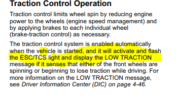

When the ESC/TCS activates the messages do come on, When the ABS (a part of TCS/ESC) the light does come on.
The manual also says:
