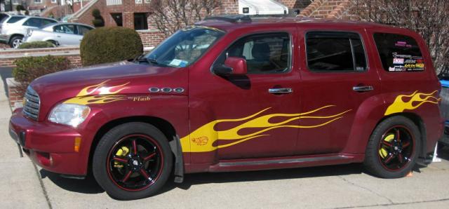

Got the car back last night, and I think the wheels look great. They are more open than my old ones and show the painted caliper and drum better. They are lighter than my old wheels. The old wheels were not polished and very hard to clean. Plus, the 20 inserts that I painted to match the car were nice and made the old wheels look like they were designed for the car, but they were not held in securely and they rattled around when I drove. The 2 front tires were getting worn and needed to be replaced soon anyway, and the car needed a wheel alignment (never had one in the past 6 years). So all in all, while the accident was a pain, I think I was able to turn the lemon into lemonade.
