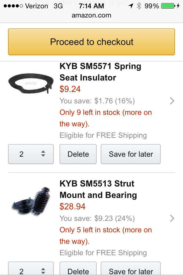

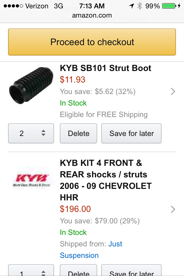

so this is what I have going so far, I think this will make everything like new, and remove noise if there is any. tell me what your guys think???
It all totals $296.22 so i figure that's a good deal for everything to be like new right?
