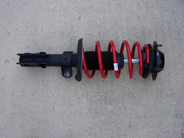

does that look like too big of a strut cover to anyone else or is that the correct size?
It does have plenty of room for it in between the existing coils, I guess.
Old Nov 8, 2014 | 06:05 PM
Posts: 11,721
Yeah, I think you've got the correct parts looked up. And that appears to be a great price for the mount AND bearing. I've seen the bearings for that much alone.
That boot will fit inside the springs. Lots of room in between the spring coils.
Like this:

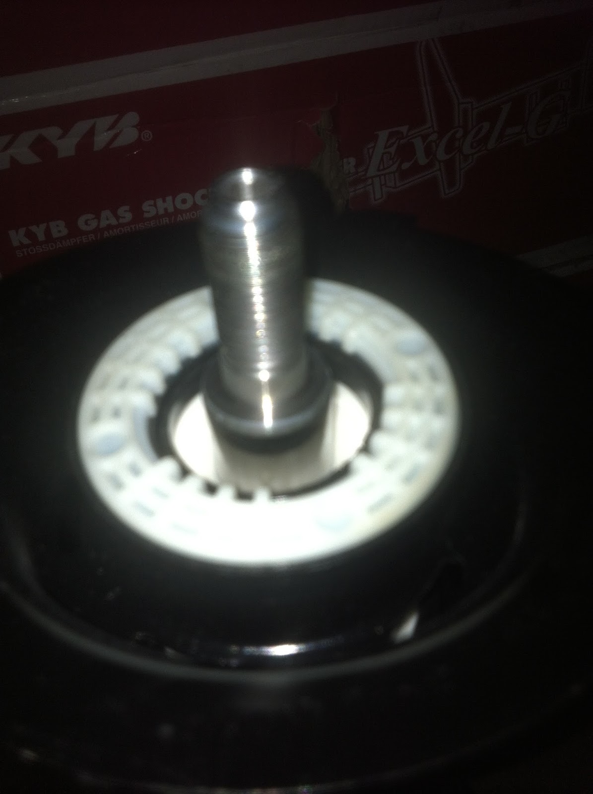

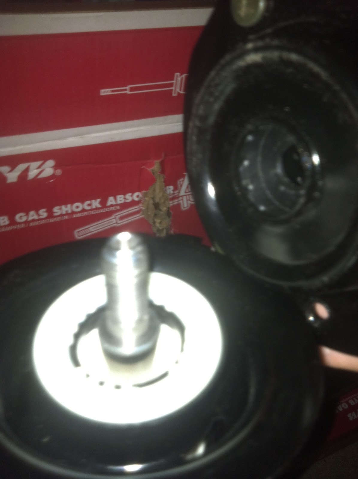

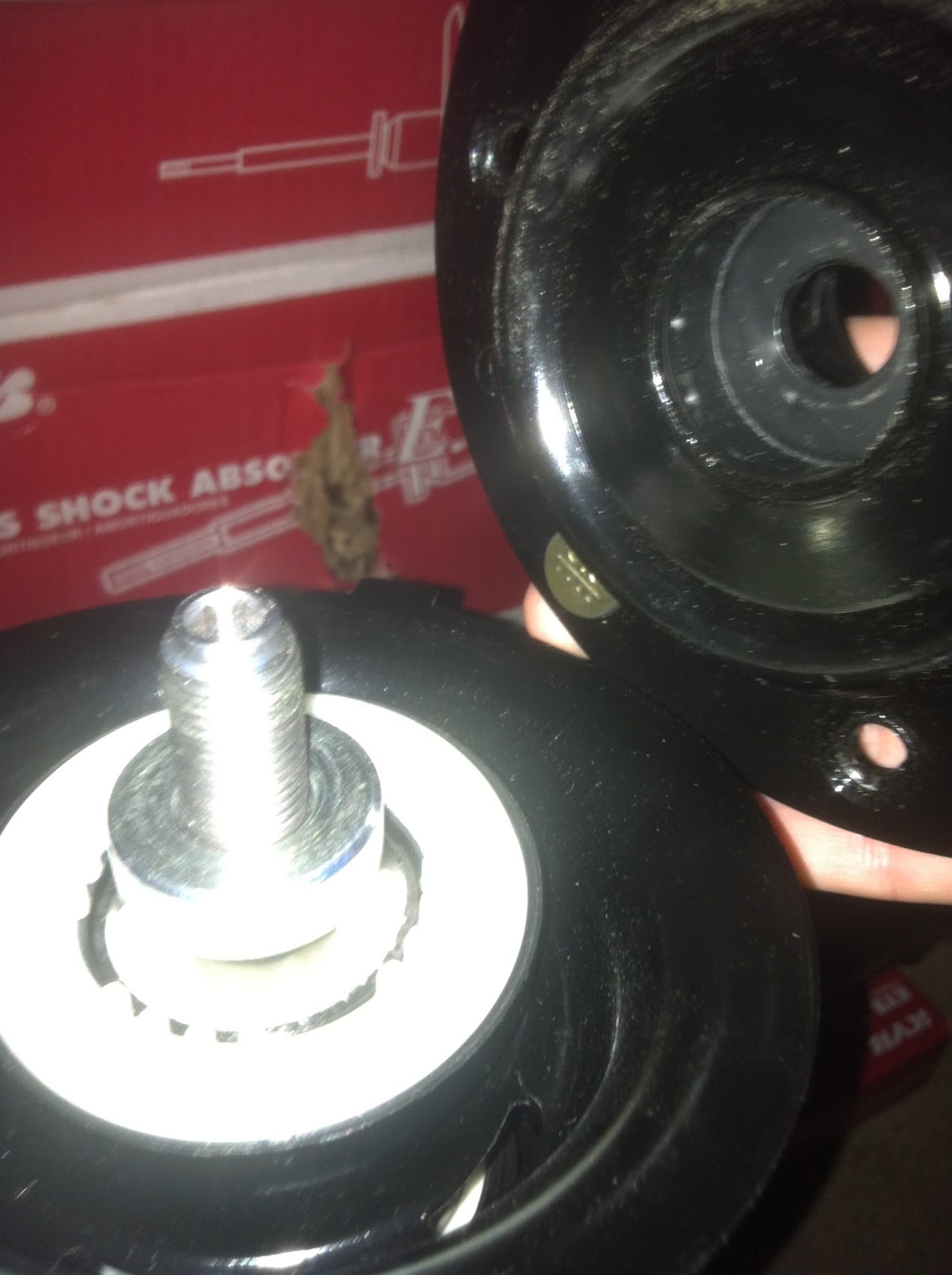

Well i got all the parts in and have two questions...
How is the bearing supposed to be installed white side up or down?
Old Nov 25, 2014 | 11:07 PM
  #30
gio89kid's Avatar
Joined: 04-07-2014
Posts: 505
From: San Diego
and...
where does the supplied washer go???
before or after the strut mount?
