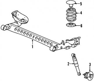

Just wondering if anyone has any information about the rear springs?
Now that the front struts are good and the rear shocks are good the rear springs squeak or creak rather when jacking up the car, or going over a bump. Is there spring insulators that they sell for the rear springs or a way to keep them quiet?
Old Dec 10, 2014 | 05:14 AM
  #42
Posts: 11,721
Yes there are. If that's whats making them squeak. Also might want to check the axle bushings too.
Check for broken springs also. Rare, but we have seen a couple posts about them being broken.
The parts should be readily available at a parts store or online.
#5 is the bump stop or jounce.
#6 is called the isolater or seat.

Hey were are you getting those schematics? They would be nice to get a hold of.
Old Dec 14, 2014 | 05:28 AM
  #45
Posts: 11,721
I get parts diagrams from various websites and save them to my computer.
That one above looks like it came from GMpartsdirect.
Most of the genuine GM parts websites seem to use the same set of diagrams.

Looks like the jounce is $30, seems expensive? Or is that the price? No one makes aftermarket ones?
Old Dec 14, 2014 | 10:18 PM
  #47
Posts: 11,721
Not really that expensive compared to ones for other cars/trucks.
I bought some for my Dodge pickup(the rubber bumper jounce on the LCA.)
Just the rubber part was $18 each.
