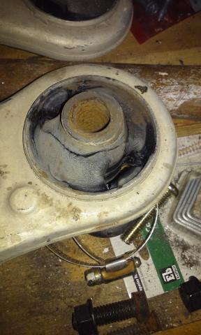

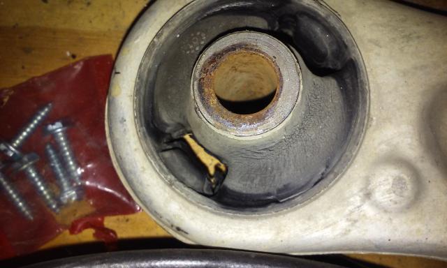

I have run into a few mechanics that refuse to believe LCAs go bad on these cars, so they will not even look at them.
It is very difficult to see the bushing. It is my personal experience that "brake judder" virtually goes away with new ones. Some other things make it go away too, but I think LCAs are the prime suspect.
The one on the left is really broken, It caused severe outside tire wear. The one on the right is just normal wear and tear(ha), just clunks.

LCA bushings are most likely the issue
