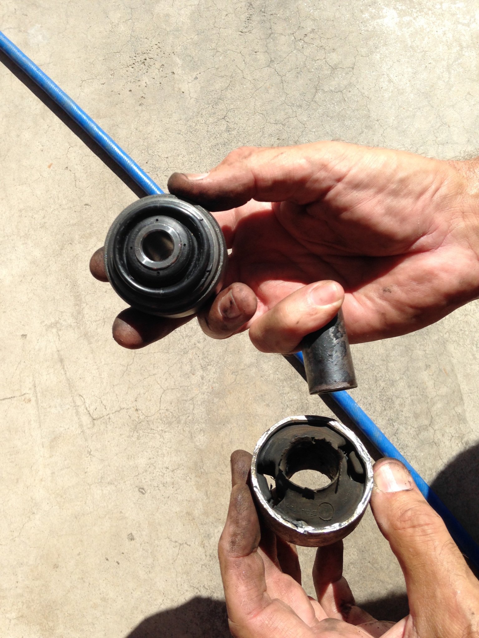

Your welcome, these OEM , LCA rear bushings on the right looked fine in the car, not so much out of the car, order up a set of Moog K200792 bearing bushings, and a set of ball joints to bolt in while you have that LCA out, it takes some drilling of the rivets and pressing of the bushings but it is worth the effort, and wait till a little warmer weather to do that job
