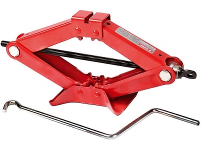

You need an elevator (or jack, I do not know the correct English word) to the front wheels do not touch the floor (hanging). The degree of compression of the spring can be adjusted with the same "jack" - to gradually lower the car onto the floor.

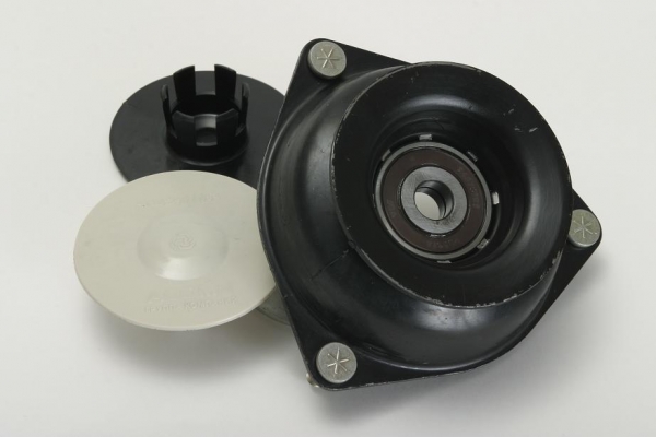

After dismantling the racks - the simultaneous inspection of the upper anchorage (again, I do not know the correct word).
There will be a shame if the new stand will have to be dismantled again for the replacement of iron gizmos.
