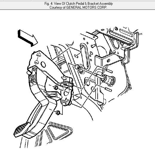

How do I remove manual pedal setup??
yes I realize thread os old but if theres a chance to get an answer l try it. Currently doing a auto to manual swap . The dash is completely out but can't figure out how to remove pedal assembly. Any help is appreciated. Thanks

Posts: 26,484
Does this help?

Posts: 39,986
Please read and look at the photos in post #1 , as you’ll see he does say he removed the dashboard and the drivetrain to remove the pedal assembly. You can also send a PM to the OP and ask questions.

Posts: 26,484
You don't need to do all of that to remove the pedals; You do need to do it to remove the plate they are mounted on to replace it with the one that has a spot for the clutch pedal.

Scott Fitzgerald's Avatar
Joined: 09-04-2020
Posts: 2
From: Pennsylvania
Automatic to manual trans swap
Yes it sure does help thank you for posting the picture of clutch pedal assy.. And the plate that it mounts to that's where I was getting lost at. Thanks again for quick response now to cancel my weekend plans and get this thing done
