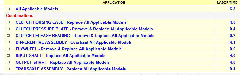

This is one form. Holds the engine up so you can drop just the frame and trans. You can even just take the strut nuts out and drop the entire assembly, then jack the body up and off. 4 bolts on the sub frame, 6 nuts on the struts, disconnect the motor mount. After that logistics is the problem.
Here is the flatrate.
Name:  clutch flatrate.PNG
