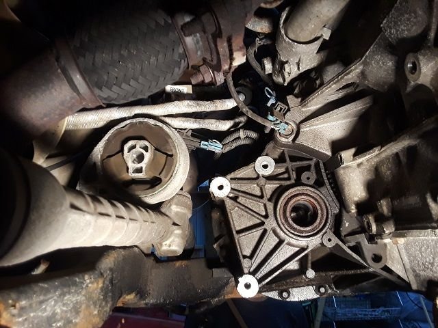

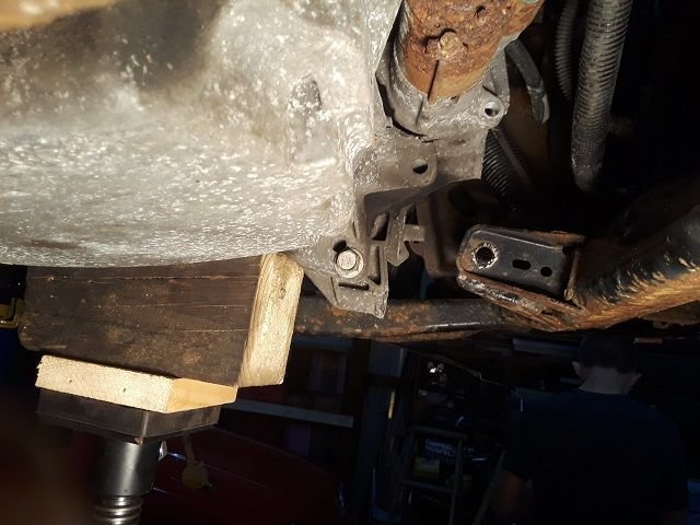

I removed the entire suspension on the drivers side, and unhooked the steering tie rod, ball joint, and sway bar link on the passenger side.
Then I disconnected the upper trans mount that is hidden under the fuse box.
I disconnected the front and rear trans mounts. To make it easier to pull the trans, I removed the mount brackets completely so they wouldn't snag on various parts:
Front Trans Mount Removed:
Rear Trans Mount Removed:

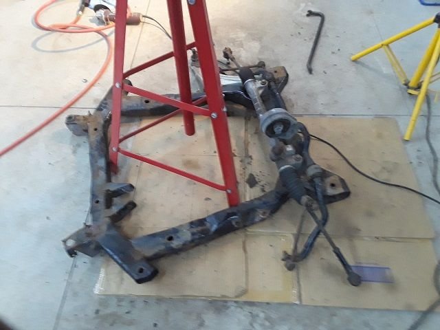

I decided to drop the entire cradle to make access easier, especially since I have to rework the rear cradle bolt nut after cutting the head off the bolt. I dropped it down and it conveniently fit on the ground around the jack stand holding the engine/trans up:

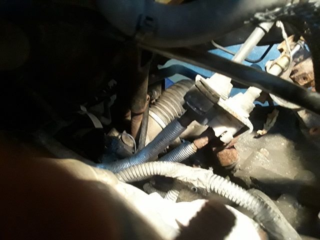

I almost forgot to mention, the steering shaft has to be disconnected before dropping the cradle:

I ended up cutting the head off the bolt so I could remove the cradle. I will need to cut the bolt in another spot to get the nut out.
I bought a new bolt at the dealer, and then went to the hardware store and bought a 14mm x 2.0 flange nut. This will replace the cage nut. The nut has to be a grade 10.9 instead of the common grade 8.8 that is usually available for metric bolts and nuts. The grade 10.9 is a higher-strength nut.
