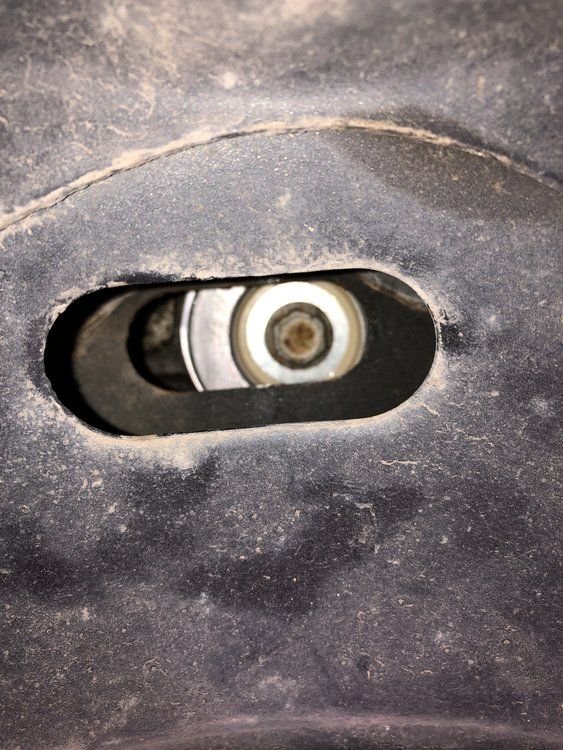

Yes, the upper engine mount is first suspect, look thru the oblong hole in the inner fender on the passenger side, see the bolt head, if it’s low and you can’t get a 15 mm deep socket on it the mount is toast.
That bolt head, it should be in the middle of the slotted hole
