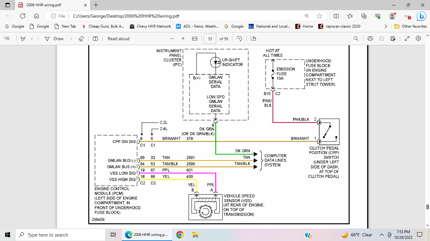

Old Oct 29, 2023 | 08:03 PM
Posts: 11,719
https://www.chevyhhr.net/forums/atta...1&d=1698627760

This 06 2.2 HHR LT
put plug in clips on wire end, switched wires no difference, car will not run
looked at coolant plug in nothing touching, looks good
Problems I may have created changing clutch
1) smashed wire end , replaced and tried with wires both ways and unplugged speed sensor plug rear of engine top of transmission. new plug from 2.4 engine has different color wires same connector
